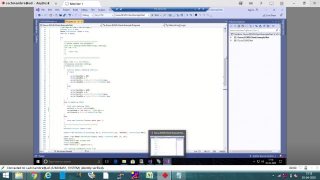

I am trying to communication secure fx100 meter using TCP/IP protocol.
meter can be communicate using GXDLMSDirector user interface, But when i tried same meter with Gurux.DLMS.Client.Example.Net then it doesn't work.
it opens media but throw error when it goes to InitializeConnection phase. in trace it gives only first line
TX: 18:32:19 7E A0 07 03 41 93 5A 64 7E
One more thing , when i tried same meter and code with NIU converter ie . modbus converter it simply communicate successfully.
can you provide root cause for the same.
