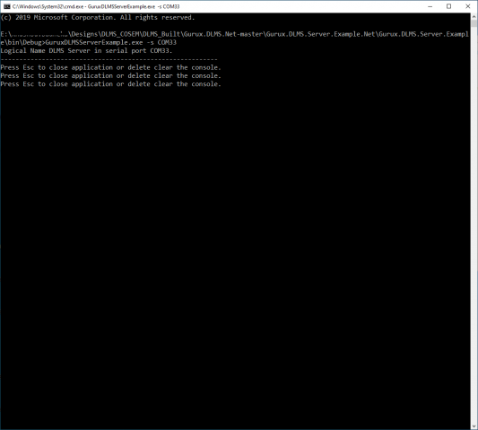

I have tried with the provided source.
As per reply #2, I have provided parameter as shown attached screenshot "SerialServer.png" and got the print as
"Logical Name DLMS Server in serial port COM33".
Then after I am trying to connect this using GXDLMSDIrector but it gives an error message "COM33" already in use.
So, How to use the serial c# server? Let me know I need to any other configuration.
PFA.
6 years 3 months ago
IF you want to use serial connection port you need two serial port and then you connect them using serial port cable. The server is using other serial port and GXDLMSDirector is using the other.
You can't share one serial port between the server and client.
