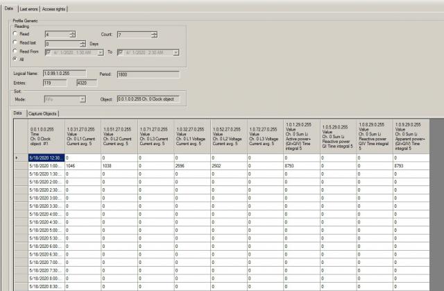

Dear Sir,
Dear Sir,
We are using GXDLMSDirector to read the meter. Please suggest us how to set the tool options for the
selected capture objects by using the range descriptor (Access selector = 1).
We are sharing the block load profile reading (1.0.99.1.0.255) screen shot.
5 years 11 months ago
Select "Read last" days. It will generate read using a given range. If you want read columns only partially then you need to make own app for that. You can use Client example as a template:
