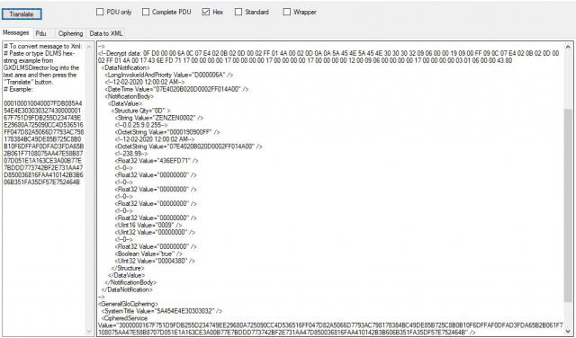

And below is the screenshot of the DLMS translator application:

Decrypted output in Translator application:
IDIS system title:
Manufacturer Code: ZEN
Function type: Disconnector extension, Load Management extension
Serial number: 3158066
<!--Decrypt data: 0F D0 00 00 6A 0C 07 E4 02 0B 02 0D 00 02 FF 01 4A 00 02 0D 0A 0A 5A 45 4E 5A 45 4E 30 30 30 32 09 06 00 00 19 09 00 FF 09 0C 07 E4 02 0B 02 0D 00 02 FF 01 4A 00 17 43 6E FD 71 17 00 00 00 00 17 00 00 00 00 17 00 00 00 00 17 00 00 00 00 12 00 09 06 00 00 00 00 17 00 00 00 00 03 01 06 00 00 43 80

So the above comments which has to be shown is not properly showing in Python SDK.

6 years 6 months ago
But the same message is properly decoding in the Translator application but not in Python sdk.
