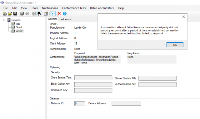

When I try to connect using
We cannot connect with GXDLMSDirector. Please see attachment.
How can I debug why is the connection failing?
6 years 4 months ago
I can't see your image. It's compressed to 600*400 and text is unclear. One of your settings is wrong.
Is that TCP/IP error or DLMS error?
Ohadi
The text of the error is:
A connection attempt failed because the connected party did not properly respond after a period of time...
It is hard for me to tell if this is a TCP/IP error or DLMS error.

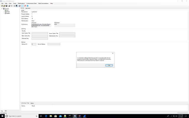

I re-captured all of the settings. I hope these screenshots are clearer.

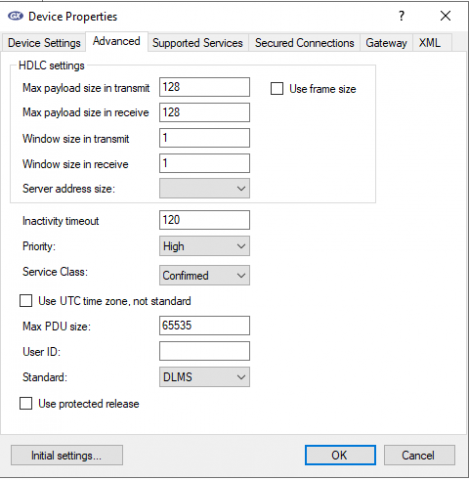

Ohadi
Ohadi
Another screenshot
Another screenshot

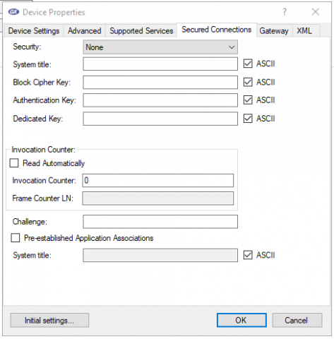

Ohadi
Secured screenshot
Secured screenshot

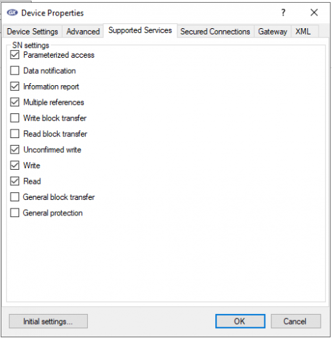

Ohadi
Supported devices screenshot

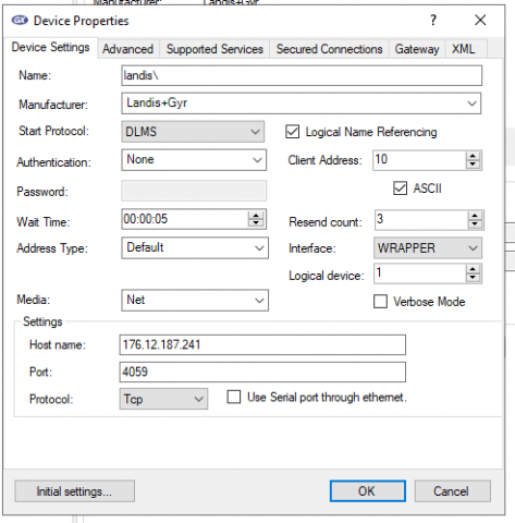

Ohadi
Settings screenshot
Settings screenshot
This is TCP/IP error. Your IP address or port number is wrong.
