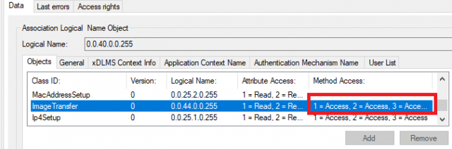

I want to update the firmware of meter using GXDLMSDirector. For that meter must be connected using Firmware Upgrade association mode.
At present meter is connected using Utility settings association mode.
So, How to connect meter using Firmware upgrade association ?

Make the connection using correct client address and authentication level.
You can see Image transfer object. Press "Update" -button and select image file.
The image is now starting to update.
There are differences between image files for different manufacturers.
Let me know if you have problems with the image file.

Secured connection has been made with proper client address and authentication level (High).
The configuration has been made according to IS15959-2 table 2.
Still, I have no access to Image transfer object. I can read only all attributes from the Image Transfer object.
Do I need to configure any other parameters for a specific FW association?
6 years 6 months ago
You need to ask from the meter manufacturer why that parameters are read-only. Is image transfer implemented for the meter? If you read the association view you can see the access level of the actions.
