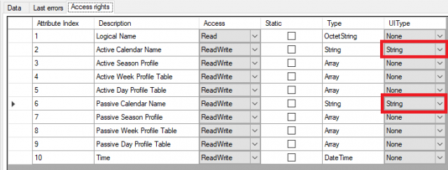

We have clients who are using non-ASCII activity calendar names. For this reason, the name is expected to be HEX string as a default. I'll try to find a way how to handle this.
In the meantime, you need to do this in GXDLMSDirector.
Select "Access rights" from "Activity calendar". Then change "Active Calendar Name" UIType from None to String. See pic below. Now you can write names as ASCII string.
Now you can receive data as expected.
