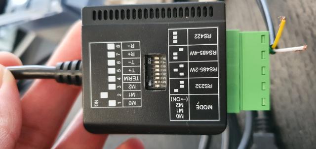

I'm looking at the manual of
I'm looking at the manual of Exsys rs485-usb converter: https://cdn-reichelt.de/documents/datenblatt/E910/EXSYS_EX1309T_MN_ENG…
The RS-485 connection the DSO placed was orignally in a rj-11 connection, I stripped it and only the green and red cable are left. Which connection do I put them in (see attached picture) ?
6 years 9 months ago
If you have only two wires use the upper (default). Lower is for four wires.

Hi Miko,
I'm still working on get some data out of the Landis+Gyr E650. I was today at the office of the manufacturer and he was able to get a reading with aan optical cable with the software of the manufacturer called .map110
We tried on his windows pc with the Exsys with .map110 over the RS485 port, but that didn't work. I'm wondering if I should install the D2XX Direct Drivers, but I think the VPC drivers that are included in the kernel should be enough.
Using the :
- Python DLMS Gurux EXAMPLE main.py to get a first sign of response.
- Connected is the Exsys USB RS485 converter, I'm using the VCP driver that is in the kernel my USB and it maps to the "ttyUSB0" port.
- For the Exsys, I'm using the `RS485-2W` diagram, pin number 2 is up and all the rest is down.
- After a `pip install -r requirements.txt` in the Client example folder.
The main command I'm resting with is python main.py -S /dev/ttyUSB0, where the result itsn't different. I see the RX light of the meter burning, but it gives the following output:
ClientAddress: 0x10
RX: 12:29:27
Check the cables if the meter manufacturer was unable to read the meter using RS-485.
Can you read your meter using an optical cable? Just add -i parameter and that should work.

Would changing the switches with Exsys help, not really sure what all of these stand for, but also putting from 4 to 8 on on, doesn't change the outcome of the commands.
