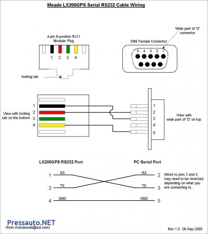

I am using l&T ER300p meter. Its gives dlms data through RS232.
Connection between rj11 to DB9 as given link https://www.pinterest.fr/pin/461056080577439131/
When I am run this command.
python main.py -S /dev/ttyUSB0
Its gives an error.....

Can you read the meter with GXDLMSDirector? Select "Indian Standard" as a manufacturer.
If you can't check the cables.

bro, has this worked for you.
bro, has this worked for you. is the pinout accurate?
