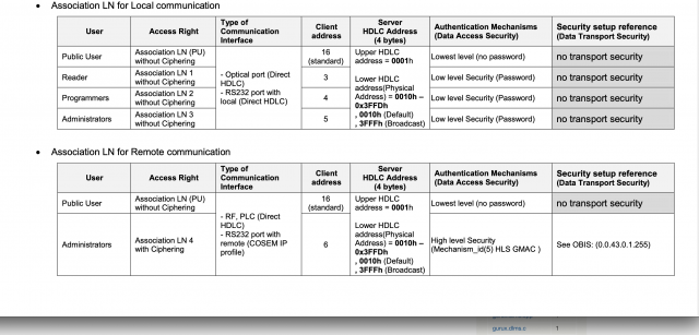

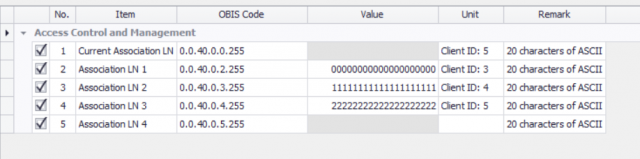

Gurux GXDLMSDriector is work for my meter
My settings Gurux GXDLMSDirector
Manufacturer: Gurux
Physical Address: 1
Logical Address : 0
Client Address: 5
Authentication: Low
Password: 22222222222222222222
Baud rate: 19200
Port COM1
