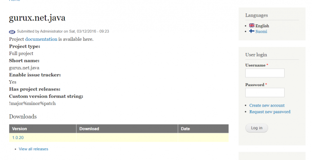

Shall it be available here: http://www.gurux.fi/gurux.net.java? I can see the information that new version has been released (1.0.20), but no download link is available.
6 years 7 months ago
It should be on the Central.
https://search.maven.org/artifact/org.gurux/gurux.net/1.0.20/jar
lrd2
You're right, I was searching
You're right, I was searching at mvnrepository.com where it wasn't available.
Method setConnectionWaitTime() on GXNet object, works great. Thank you :)
