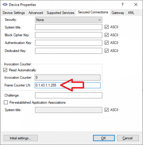

Make connection to the meter without authentication. Read Association view. There is something like:
Management Frame Counter in data objects. Copy Logican Name (OBIS code) of that data object.
Select "Secured connections" -tab from device settings.
Paste Logical name to "Frame Counter LN".
Now Frame Counter is read and updated automatically.

6 years 9 months ago
The frame counter is updated properly in both MR and US associations.
But after that object list is not downloaded and got the same error as below:
Gurux.DLMS.GXDLMSException: Access Error: Device reports a undefined object.
Is the exception coming in the same place? Check that your keys are correct and the Invocation counter is increased.
