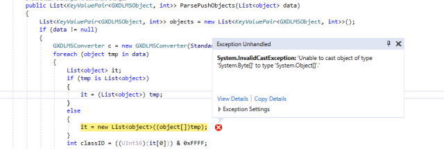

Not the same case as above but similar. We now handle push data from other manufacturer where we are supposed to handle data notifications.
Example data:
0 01 00 01 02 01 00 23 0F 40 00 00 00 0C 07 D0 01 01 06 02 25 38 FF 80 00 00 02 02 09 06 00 00 61 62 00 FF 06 00 00 00 04 22 25
code snippet:
var frameComplete = client.GetData(new GXByteBuffer(kaifaPushEvent), replyData, notify);
if (notify.IsComplete && !notify.IsMoreData)
if (notify.Command == Command.DataNotification)
if (notify.Value is GXStructure dataNotifications)
var parsedDataNotifications = client.ParsePushObjects(dataNotifications);
//TODO: Implement data notification handling
We get an exception in ParsePushObjects, see image. The problem seem to be that it expects all objects in list to be List<object> (GXArray?) however the GetData method has created them as byte[]
/Björn
AndreasAtPowel
6 years 7 months ago
Forgot yo mentioned that we
Forgot yo mentioned that we have ported our code to version 9
You can use Version 8. We'll fix this today.
This is fixed. There is a new version released.
AndreasAtPowel

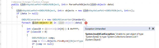

Still issues with new version
Still issues with new version. I thing this is just the symtom, the error should be fixed in GetData
You can't use ParsePushObjects for this data. You need to get data by yourself.
The problem with push messages is that the content of push data can be anything.
Meter can be configured to send almost any data.
http://www.gurux.fi/GuruxDLMSTranslator?translate=00010001020100230F400…
In your push message, there is a structure where are two values (Logical Name and UInt32).
I don't know what push message this is. I believe that it's alarm register object. Data is occurred alarm, but it's not possible to know if you don't know how meter is configured.
