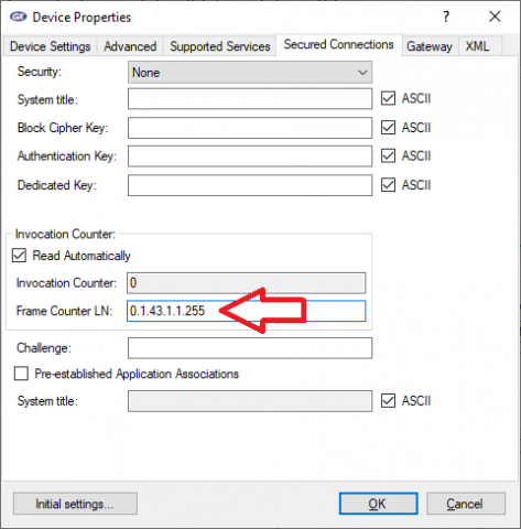

By Bhaumik, 21 November, 2019 Forums Gurux.Net Hi Mikko, I am trying to connect - disconnect meter multiple times. As meter required Invocation counter value higher than previous value for reconnecting. I can connect meter from GXDLMSDirector only by giving the updated value of the Invocation counter in device properties. GXDLMSDirector always takes Invocation counter value as 0 in reconnect. Is there any other settings in GXDLMSDirector from which it takes updated Invocation Counter value? Hi, Hi, Select "Secured Connections" tab. Set OBIS code where you are reading Invocation Counter to "Frame Counter LN". After that, it's read automatically. This is not implemented yet for example clients, but it's on progress. BR, Mikko Image Hi Mikko, Hi Mikko, Is there any way we can reset the Invocation counter? Hi, Hi, It depends on the meter. Usually no. BR, Mikko Log in or register to post comments
