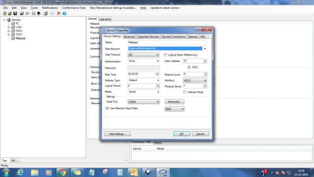

Hello all,
I'm trying to read GAMA 100 Type G1B,164 DLMS meter using GuruX. When I tried to send SNRM frame (7E A0 07 03 21 93 0F 01 7E) I am not receiving any response from meter. Can anybody guide me how can I read this meter.
I had selected Elgama Elektronika Manufacturer in GuruX.
I am trying to read Public Client association with client address as 10.
I had tried reading this meter from both Optical and RS485 interfaces but failed to receive response from meter. I don't know whether I am doing any mistake.
Please help me to solve this problem.
This meter is Class 1 and IEC 62053-21 std. Made in Lithuania.
I had also attached screenshot of GururX settings ehich I configured.
SNRM FRAME: 7E A0 07 03 21 93 0F 01 7E
Thanks in advance

IEC 62053-21 and DLMS are different standards. DLMS is defined on other IEC 62056 standards.
http://www.gurux.fi/DLMSCOSEMFAQ
If there is a DLMS name plate, then your meter is also supporting DLMS. If you are using optical probe. you should select IEC as a start protocol. Start baudrate usually is 300.
