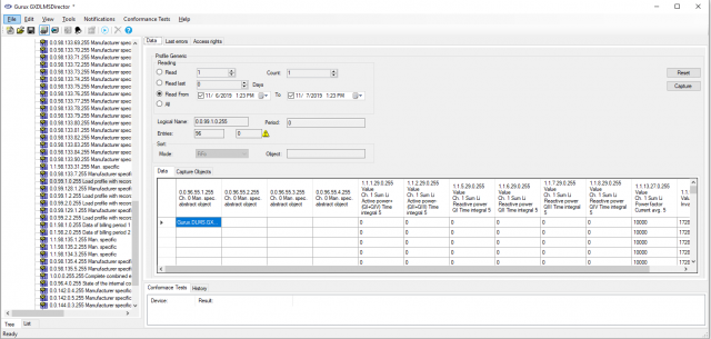

I can read the same period with the GXDLMSDirector. Although it shows a "Access Error: Device reports scope of access violated" warning for the right cell of entries, it gets 96 entries. I have attached a screenshot of GXDLMSDirector. It shows the cell with the access error.

I didn't remember, but this is the data that SL7000 is sending. It's an older device and not support DLMS very well. You need "Logical Devices SK761" -document to find out what meter is returning.
You need to ask it from the meter vendor.
