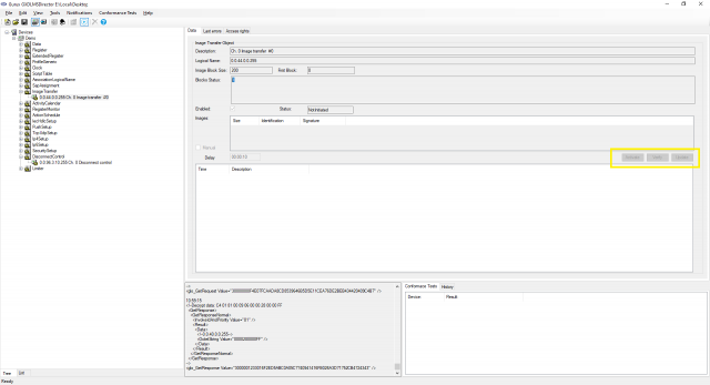

I am trying to read Image transfer DLMS object from Indian standard meter (IS15959-2) using the GXDLMSDirector application.
Meter is connected with High-level security.
I can read all attributes from meter but In that why Activate, Verify and Update buttons are disabled? Please find the attached screenshot for the same.
Is there any configuration from the GXDLMSDirector application?
6 years 8 months ago
You don't need to configure GXDLMSDirector. All the settings are read from the meter.
Check is image transfer methods allowed from Association Logical Name.
I believe this is the reason.
