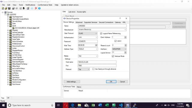

I am new commer in dlms and have a problem in server connction
Smart meter is Actaris electricity type and it connected to server. But it does not reply to server response. It connect via optical usb cable easily
There is any notice here i missed it?
Do you have any same exprience?
7 years ago
You need to use the client app to read your meter. The best way to start is if you download GXDLMSDirector and start with that.
Profile picture for user kamerdack
kamerdack
7 years ago
Thanks for reply.
Thanks for reply.
I used GuruxDLMSDirector. It can connect by optical calble but when i choose Net as Media and set Server ip and WRAPPER interface, as shown as attached screenshot i have not any reply.
Even i set Use Serial port through... it has not any action
I attached both mode, Serial port log and Server log in attached files.
Where can i find a released build file for server. I code my own simple server like a chat app so it send recieved daya stream for the otherside of client. You imagin we have two client Glxdirector and smart meter via GPRS here
I would be appreciate in case that you guid me.

WRAPPER is used only with TCP/IP connection and all the meters don't support it.
If you are using Moxa, you still need to use HDLC frames, even data is sent in TCP/IP network.
So change Wrapper to HDLC and make a new try.

The first data from smart meter after connecting to server seems that is in wrapper. It s like this;
Data exchanging in GPRS and GDirector
01/11/2019 13:35:48] Read data (COM10)
00 01 00 01 00 66 00 19 0f 00 00 06 92 0c 05 76 .....f......’..v
08 0a 05 0d 24 00 00 00 00 00 02 01 06 00 00 20 ....$..........
00
Maufture in glx file is Actaris electricity
I could not build server codes in C or C++. There is some error. Do u have any build file for running in ubuntu?

7 years ago
There is makefile for ANSI C and ANSI C++.
Just run make.
