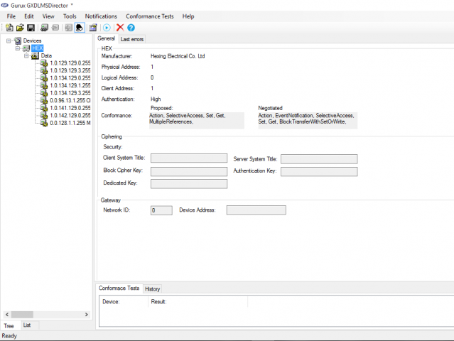

ok i have just tried it, and
ok i have just tried it, and it connected. I looked up GXDLMSDirectorExample link to know what to fill for hex meters and it connected. after connecting, the data objects below the device i created, when i try to read em i get "no response" pop up. how to i read, or do i need to add data objects myself?

device properties
device properties: with 300 baud, 7 bits, even parity, one stop bit.

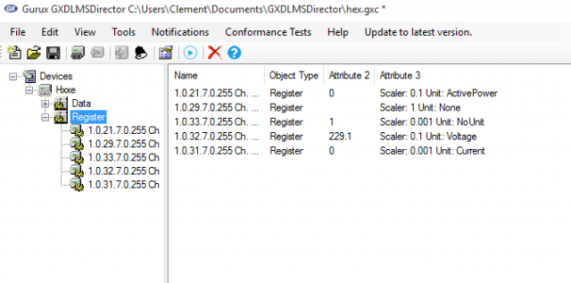

I have been able to successfully read the Hex meter using GXDLMSDirectorExample, and i tried the obis codes from the hex meter documentation to read out certain parameters and it did. Now i'm trying to use a raspberry pi to read certain information from the meter via optics and I need a python sample for this meter.

thanks for your reply, I have been able to successfully read the Hex meter using GXDLMSDirectorExample, and i tried the obis codes from the hex meter documentation to read out certain parameters and it did. Now i'm trying to read certain information from the meter using the gurux python library via optics. below is the reading i got with the app and i would like to get it using python. what arguments do i need to pass to the main.py file based on the parameters inputed in the GXDLMSDirector app as shown in my previous reply.
6 years 9 months ago
I believe that you need to change the authentication level if the OBIS code that you want to read is not shown on the association view.
