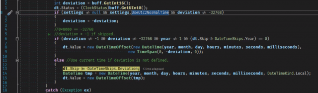

We have debugged it into GXCommon.cs, and noticed that the Deviation bytes that are sent to us by the meter contains the following value:
0x8000
Line 822 of GXCommon.cs contains the following comment:
//0x8000 = -32768
If this value is returned, Gurux will default to current time in stead of using a deviation.

If meter sends 0x8000, the only option is use PC's time zone. There is no way how to get it somewhere.
From the source code:
if devitation is 0x8000
DateTime tmp = new DateTime(year, month, day, hours, minutes, seconds, milliseconds, DateTimeKind.Local);
Mkko
