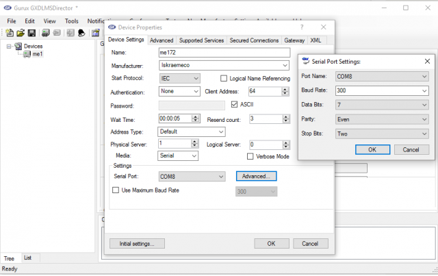

Hello
Im trying to connect my iskraemeco ME-172 with gxdlmsdirector
ive compleated all the required items and when i press CONNECT it says :
"failed to receive reply from the given device"
plz help
6 years 11 months ago
Your meter is using IEC 62054-21, not DLMS. You can't read the meter with GXDLMSDirector.
