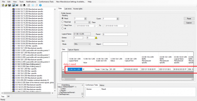

I have managed to read the records of an actaris meter. But what interests me most is to read a record of the 'Profile Generic' 0.1.98.1.0.255.
I am using Python 3.7.
If you could tell me how reading these records would be, I would appreciate it.
I tried with
GXDLMSProfileGeneric ()
and with readRowsByEntry ()
but I haven't got much
To read this record in 'GXDLMSDirector' I achieve it with read 1 count: 1
Getting the data I need
Thank

I don't get the results when I do this I get:
gurux_dlms.GXDLMSException.GXDLMSException: Access Error : Unknown error.
Maybe I could give an example of reading the data I need.
I propose you to place an ACE6000 meter so that you can access it from the internet, to formulate the example, and if it helps you to acquire experience or try something.
I attached a photo of what I want to get, obtained from the GXDLMSDirector
Connection data is passed to you as private. I'll even give you an example of a date reading
thanks
