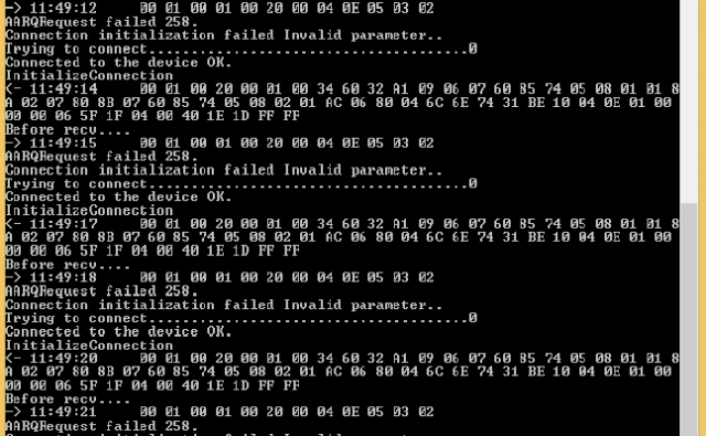

I have implemented two threads in my application. One for connection and another for reading. In this implementation only one thread run at a time. If application is connected to the meter, then connection thread will close and reading thread will run and vice versa.
I am facing problem in this implementation that some time it works properly and some time not.
Problem-1:
Whenever I remove the Ethernet cable from meter port then, the connection thread is running and try to connects. Some time it connects properly and some time the function comm.InitializeConnection() fail and returning error number "258".
Problem-2:
Whenever I remove the Ethernet cable from meter port then, the connection thread is running and try to connects. Some time it connects properly but sometime the reading thread does not release and stuck somewhere. So my connection thread does not run.
Both threads are mentioned below.

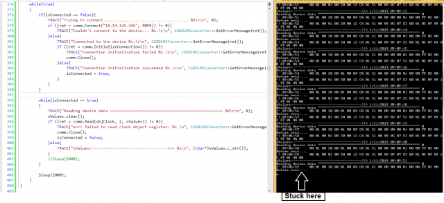

pradson
6 years 9 months ago
In reply to Hi Pradson, by Kurumi
Thanks for reply.
I have implemented same as suggested by you. It is working properly first time. Whenever I remove Ethernet cable from the meter,
then it is still stuck in the read() function. Actually the comm.read() function is not releasing that's why it is not trying to reconnect the meter.
I have attached application code and its output screen shot.
Kindly suggest me what should i do.
Thanks & Regards,
Pradson

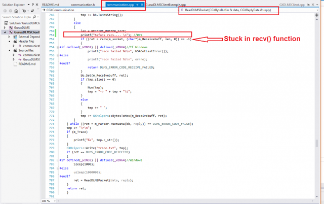

pradson
In reply to Hi Mikko, by pradson
Kindly find the screen-shot
Kindly find the screen-shot of "communication.cpp" file and its function "ReadDLMSPacket()". I have mark where it is stuck.
Pradson
Example is using default timeout.
You can change it setting this after you create the socket.
// WINDOWS
//Timeout in seconds.
DWORD to = timeout * 1000;
setsockopt(m_socket, SOL_SOCKET, SO_RCVTIMEO, (const char*)&to, sizeof to);
// LINUX
struct timeval tv;
tv.tv_sec = //Timeout in seconds.;
tv.tv_usec = 0;
setsockopt(m_socket, SOL_SOCKET, SO_RCVTIMEO, (const char*)&tv, sizeof tv);

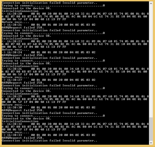

pradson
Thanks for reply.
It is working as suggested by you.
But I am facing one more issue that whenever i remove the Ethernet cable from the meter, then it goes in re-connection loop and trying to reconnect till now it get connected.
Sometime the above scenario is work properly and some time faces re-connection error of "AARQRequest failed 258". It means the function "comm.InitializeConnection()" is not succeeded. In this situation I have to re-start the meter, then it get connected and read the data from the meter.
I have attached screen-shot for the same.
Kindly check and suggest.
Thanks & Regards,
Pradson
If you have established the connection to the meter and connection broke you need to wait until inactivity timeout has elapsed before trying the next connection. You can check what is inactivity timeout from the "IEC HDLC Setup" object.
pradson
Thanks a lot Mikko.
Thanks a lot Mikko.
Now it is working fine.
All issues have been resolved.
