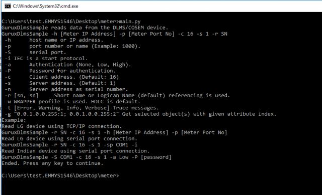

  3. How To Run Python Frmaework In Windows?
how to run python frmaework in windows?
By Ram , 16 July, 2019
Gurux.Serial
Im running my python library but im getting error like this
PFA

I believe that your python version is wrong. Try to run this as "python3 main.py".

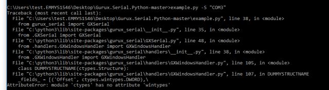

Ram
6 years 11 months ago

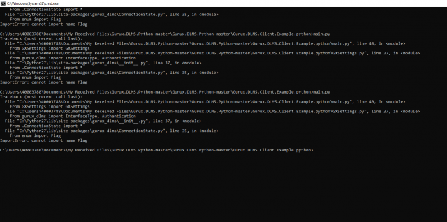

we run the code like as u said but im getting this error.
please check it once.
HI,
HI,
run this:
pip install --upgrade gurux-serial
pip install --upgrade gurux-dlms
We are working with the video at the moment.

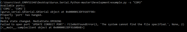

Even though we gave correct port number we are getting this error.
You need to change "UPDATE CORRECT PORT" to "COM1" or "Com3" in the example.py.

Ram
we run the code like as u explain in the video but we are getting like this.
we checked from meter side also but we are able to read the values in GXDLMSDIRECTOR successfully
What serial port you are using? Is that connected to the USB port? Can you give link to the manufacturer page?

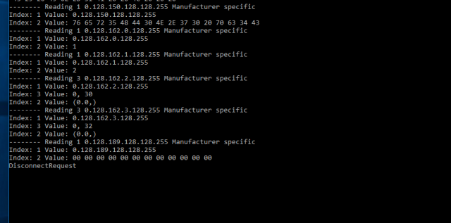

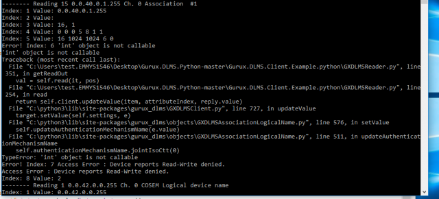

While running the code we are getting the error as below.
please check the picture what i send

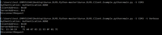

Ram
After reading it is
After reading it is successfully disconnected but still it is in waiting stage and it is not coming back to console(not terminating).
please check the picture what i send.

Please, don't send pics. It's hard to get data from there. Paste received bytes and I'll check it. Don't paste all data, just failed one and.
updateAuthenticationMechanismName is fixed and a new version (1.0.17) is released. It'll fix the first image issue.
Can you run the app with -t Verbose parameter and send DisconnectRequest data. I need to check why meter is no reply.

We tried with updated code
We tried with updated code but we are getting the same error.
Did you run pip install --upgrade gurux-dlms? jointIsoCtt is fixed and it succeeds.

Ram
Yes that problem is sorted
Yes that problem is sorted out now.
Only problem is now after reading data it is showing disconnected request then the console is not coming back.
Can you run the app with "-t Verbose" parameter and send DisconnectRequest data. I need to check why the meter is no reply.
