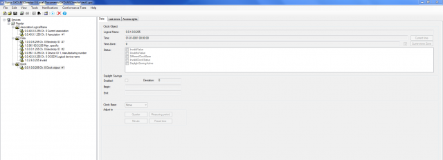

As you instructed I have used latest version and now I am able to read the data from meter with authentication level "None" but still I am only able to read just 3 types of objects data.
Please refer the attached screenshot of DLMSDirector "Objects.PNG" and answer the following query.
1) During the association view meter responding only 3 objects. How can I read all supported objects(OBIS code) from meter as I am reading via optical port?
2) Is authentication level required to read the data other than this 3 objects ? Please tell me so I can connect with my vendor to get the password.
3)Is there any restriction possible like you have to used at least "Low" level authentication to get the other data OR you have to read from RS232 port instead of Optical ?
*Note : Meter - Secure Sprint350, Communication - Optical port for local communications and optional RS232 (RJ-11 port) for remote communications.*
Thanks In advance.
7 years ago
You should change authentication from None to Low or High to read all objects.
You need to ask what authentication levels meter supports and password.
Security levels and possible restriction are depending on the manufacturer.
