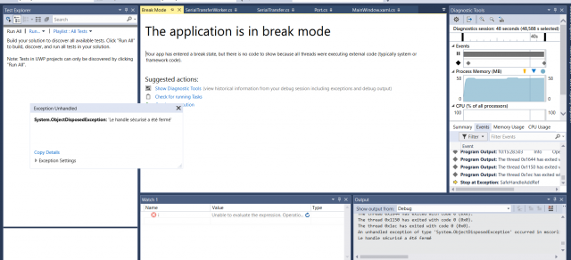

I started testing the gurux.serial solution on the .net platform. The provided test project works perfectly
(one COM port)
Unfortunately when I push a little further the tests I find that after opening 10 ports after a few seconds,
up to 2 minutes I have an exception :
System.ObjectDisposedException
HResult=0x80131622
Message=Le handle sécurisé a été fermé
Source=mscorlib
StackTrace:
at System.Runtime.InteropServices.SafeHandle.DangerousAddRef(Boolean& success)
at System.StubHelpers.StubHelpers.SafeHandleAddRef(SafeHandle pHandle, Boolean& success)
at Microsoft.Win32.UnsafeNativeMethods.GetOverlappedResult(SafeFileHandle hFile, NativeOverlapped* lpOverlapped, Int32& lpNumberOfBytesTransferred, Boolean bWait)
at System.IO.Ports.SerialStream.EventLoopRunner.WaitForCommEvent()
at System.Threading.ThreadHelper.ThreadStart_Context(Object state)
at System.Threading.ExecutionContext.RunInternal(ExecutionContext executionContext, ContextCallback callback, Object state, Boolean preserveSyncCtx)
at System.Threading.ExecutionContext.Run(ExecutionContext executionContext, ContextCallback callback, Object state, Boolean preserveSyncCtx)
at System.Threading.ExecutionContext.Run(ExecutionContext executionContext, ContextCallback callback, Object state)
at System.Threading.ThreadHelper.ThreadStart()
Yet I'm only opening port, I overload events onerror (), onreceive (). But no other action, neither closing
of port, nor sending of character on the line, I do not trigger reception.
The COM port used are virtual COM created with VSPE.
I have provided you my very simplified test project by mail since the zip file is not autorized on post.
Do you see something that I have not implemented correctly?
Thank you in advance for your help.
Best regards,
Nicolas.
