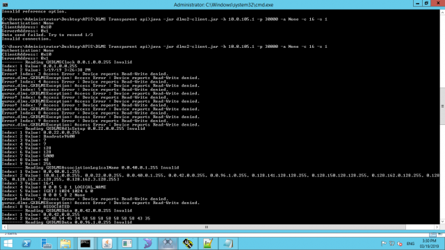

I am new to this. while trying to connect to meter using following command
java -jar ......jar -h [IP] -p [port] -a None -c 16 -s 1
It is giving following error...
Reading GXDLMSClock 0.0.1.0.0.255 invalid.
PFA....
Kindly help me out to resolve.
Maruthi
7 years 6 months ago
It seems that you can make the connection to the meter. You try to read objects that are not on the meter or you don't have the access right for them. Try to change the authentication level and read again.
