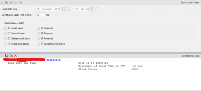

6 years 10 months ago
You need to read the date-time from the meter and post only the read response here.

However, it's a bit confusing because when I read the meter with .map110, it looks like it can handle timezones (please find the screen below).

If you can send me the Map 110 trace, I can check it, but I believe that value is converted to UTC time before send.
