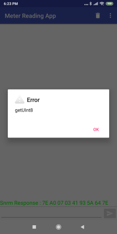

Sir,
Sir,
This the authentication request:
7E A0 07 03 41 93 5A 64 7E
I am sending it through GXDLMSSecure client as:
secureClient = new GXDLMSSecureClient(true, 32, 1, Authentication.LOW, "XXXX", InterfaceType.HDLC);
I am giving you the converted response.

The request is correct. What is the reply?
Sir,
Sir,
Please see the attached screenshot after last 7E. I am receiving that response with error.
Thanks !
Regards,
Sarbjit Singh

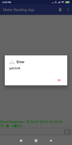

Can you print reply as hex string?
Sir,
Sir,
Please see the response in hex below the error message in attached screenshot.
Regards,
Sarbjit SIngh
This is the echo. This is not a reply from the meter. You have sent this data.
